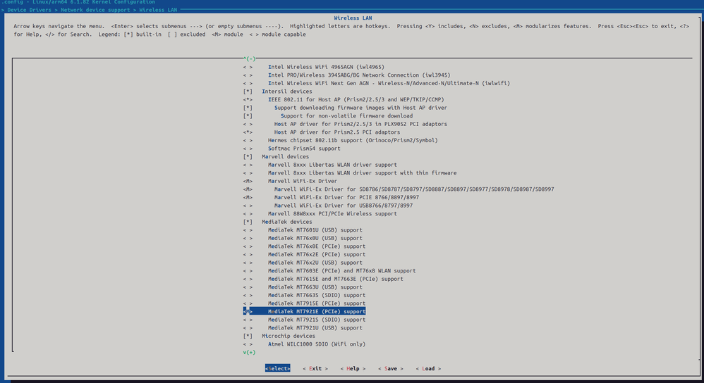

I install the mini PCIe MT7921 wireless network card on stm32mp257f-ev1 board.
root@stm32mp2:/# lspci
00:00.0 PCI bridge: Synopsys, Inc. Device 0550 (rev 01)
01:00.0 Network controller: MEDIATEK Corp. MT7921 802.11ax PCI Express Wireless Network Adapter
The device is normal.configure the kernel and use MT2791(pcie) ,after compilation, update the kernel and modules using the scp command.
