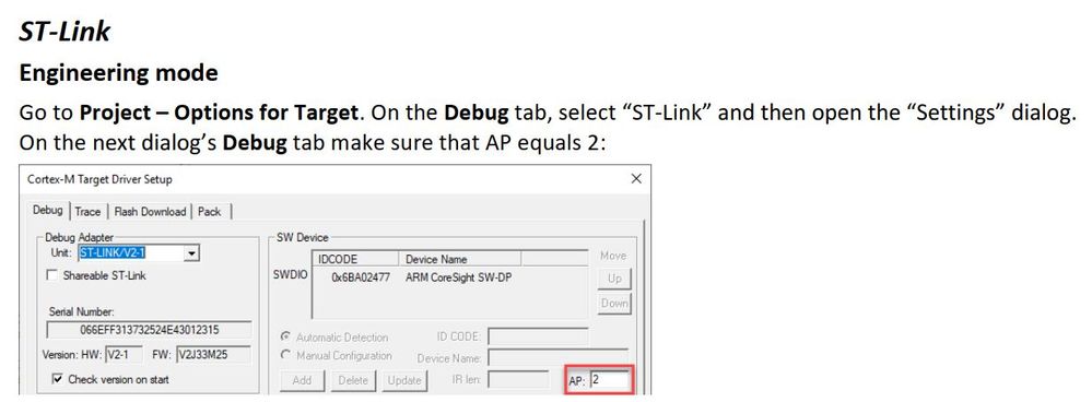

I think it is because of the differences between HW Vesion and FW in keil document and my results.
In attachment image is mentioned stlink v2-1.
Best regards

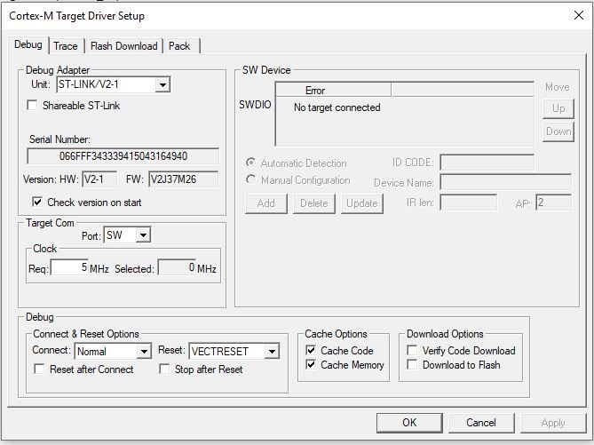

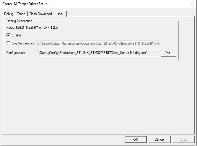

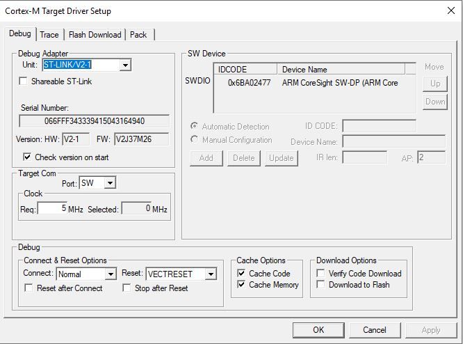

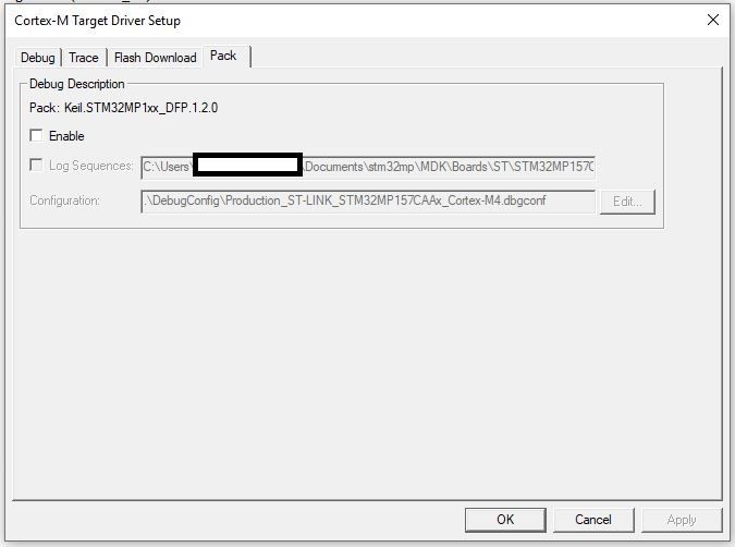

Now i use On-board ST-LINK/V2-1 . when i uncheck enable pack (third image) the target cant be recognize(fourth image).
