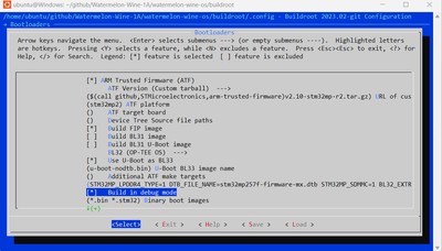

I have built a custom board by using STM32MP257F and I want to boot on USART6.
I have not succeed to boot on USART6 when I compile my own fsbla by change the device tree of TF-A.
I got a suggestion from ST Dev team to run this ROM tracedump wiki-stm32mp-addons/MP2RomTracesDump at 6.1.0 · STMicroelectronics/wiki-stm32mp-addons · GitHub and it gave me a positive output on USART6.

Question:
I'm planning to use USART6 as early debugging but I need to know what settings the ROMtracedump had for displaying and using USART6.
My Device Tree for TF-A have this following setting. But still, this won't work. I don't know why it won't work. Perhaps if I could know the settings fom the ROMtracedump, then I could understand why the USART6 is working as early debugging and not for my Device Tree for TF-A.

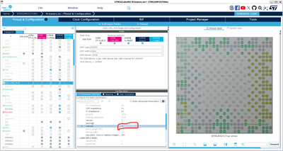

Hello @DMårt
To fix the wrong memclk value in your DDR configuration, you have to go in "Clock Configuration" tab and update the clock divider going "To DDR", around PLL2 clock mux.
Hope it helps,
BR,
Kevin
NEW ! Sidekick STM32 AI agent, see here
Hi @Kevin HUBER
I have set my DDR to 600 MHz in the clock configuration tab so the memclk becomes 1200 MHz.
I will now see if USART6 is working as early boot debug. Perhaps not...

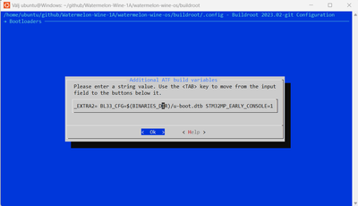

Hi @PatrickF @Kevin HUBER
I did that. But no text at the bootup. Nothing at all.
I have enabled usart6 at my device tree.
The USART6 is using HSI_KER clock at 64 MHz in CubeMX.

Here is the correct settings for USART6 for early console. I was misstaken for DEBUG_UART_TX_GPIO_ALTERNATE should have the number 8, i.e AF8, but according to the datasheet, it must have number 3, i.e AF3.
/* USART6 on HSI@64MHz, TX on PF13 Alternate 3 */
#define STM32MP_DEBUG_USART_BASE                USART6_BASE
#define DEBUG_UART_TX_GPIO_BANK_ADDRESS         GPIOF_BASE
#define DEBUG_UART_TX_GPIO_BANK_CLK_REG         RCC_GPIOFCFGR
#define DEBUG_UART_TX_GPIO_BANK_CLK_EN          RCC_GPIOxCFGR_GPIOxEN
#define DEBUG_UART_TX_GPIO_PORT                 13
#define DEBUG_UART_TX_GPIO_ALTERNATE            3
#define DEBUG_UART_TX_CLKSRC_REG                RCC_XBAR8CFGR
#define DEBUG_UART_TX_CLKSRC                    XBAR_SRC_HSI
#define DEBUG_UART_TX_EN_REG                    RCC_USART6CFGR
#define DEBUG_UART_TX_EN                        RCC_UARTxCFGR_UARTxEN
#define DEBUG_UART_RST_REG                      RCC_USART6CFGR
#define DEBUG_UART_RST_BIT                      RCC_UARTxCFGR_UARTxRST
#define DEBUG_UART_PREDIV_CFGR                  RCC_PREDIV8CFGR
#define DEBUG_UART_FINDIV_CFGR                  RCC_FINDIV8CFGR
. Here is the output result:
NOTICE:  Early console setup
ERROR:   failed to enable clock id: 5
BACKTRACE: START: clk_stm32_enable_call_ops
0: EL3: 0xe017bac
1: EL3: 0xe01be2c
2: EL3: 0xe01beb0
3: EL3: 0xe01bf54
4: EL3: 0xe01c240
5: EL3: 0xe01db28
6: EL3: 0xe029a2c
7: EL3: 0xe0170dc
BACKTRACE: END: clk_stm32_enable_call_ops
PANIC at PC : 0x000000000e01be34
