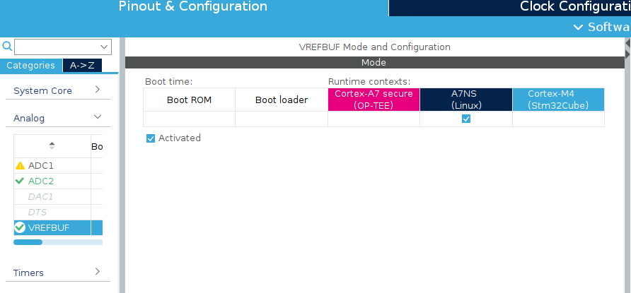

To be able to get a usable value by reading the ADC, you must have a reference which is VREFBUF.
I advice you to read the reference manual (RM0436 revision 5) page 1693: https://www.st.com/resource/en/reference_manual/DM00327659-.pdf
and the ADC page on the wiki: https://wiki.st.com/stm32mpu/wiki/ADC_internal_peripheral#Features
Then you have two choices to enable VREFBUF.
If you are not using linux you have to enable the VREFBUF after the ADC_Init() but before starting it:
__HAL_RCC_VREF_CLK_ENABLE(); // Enable the VREF clock
HAL_SYSCFG_VREFBUF_HighImpedanceConfig(SYSCFG_VREFBUF_HIGH_IMPEDANCE_DISABLE); // Disable the high impedance mode which is the default one read page 1694 of refman
HAL_SYSCFG_VREFBUF_VoltageScalingConfig(SYSCFG_VREFBUF_VOLTAGE_SCALE1); // To set the volage to 2.5v
HAL_SYSCFG_EnableVREFBUF(); // To enable VREFBUF

You have to enable VREFBUF in the DTS for making it startable by Linux, you can enable it with CubeMx.
Then you have to configure the VREFBUF, I advise you to read this page:
https://wiki.st.com/stm32mpu/wiki/Regulator_overview#Microcontroller_device_internal_regulator
In a first time, I advise you to start by testing your code in engineering mode.
Note that this is setting VREF+=2.5V, so conversion range between 0 and 2.5V.

2022-02-10 10:33 AM
@Kevin HUBER thanks for your help, but I'm unfortunately still having issues after the suggested changes. Can you please check to make sure I'm implementing your change correctly?
ADC_Init seems to be called in MX_ADC2_Init that was generated by the IOC.
So I've modified that function in the user editable portion as per your comments to the following:

}I'm also not clear on what engineering and production mode are, are those debug and release respectively?
I'm actually not physically connected to the stm32mp1 as I'm on an M1 and had problems building locally. So I've got a linux VM and I'm transferring the debug build to the MP1 over scp and then using the `fw_cortex_m4.sh` to get the binary on the M4. I'm not sure if this is causing issues.
