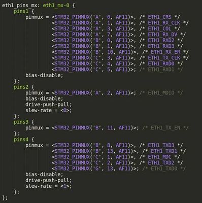

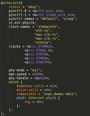

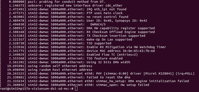

It seems that I have a problem with DMA, but I'm not sure. Would you please take a look at the below screenDts looksI intend to achieve MII with self-generated quartz.Unfortunately, I'm stuck on this "Failed to reset the DMA".
