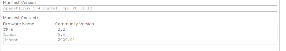

Hello @WLeun.3 ,
You have to use the version of CubeMX delivered with your OSTL (5.4) version which is the STM32CubeMX6.1.
Wiki: https://wiki.st.com/stm32mpu-ecosystem-v2/wiki/STM32MP15_ecosystem_release_note_-_v2.1.0#STM32CubeMX
STM32CubeMX v6.1 -> This one generates Device tree compliance with openstlinux-5.4-dunfell-mp1-20-11-12 tag
To my knowledge there is no other way to use an old version of OpenSTLinux.

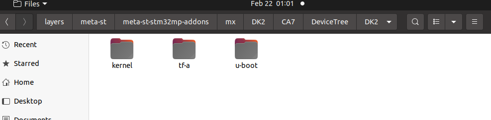

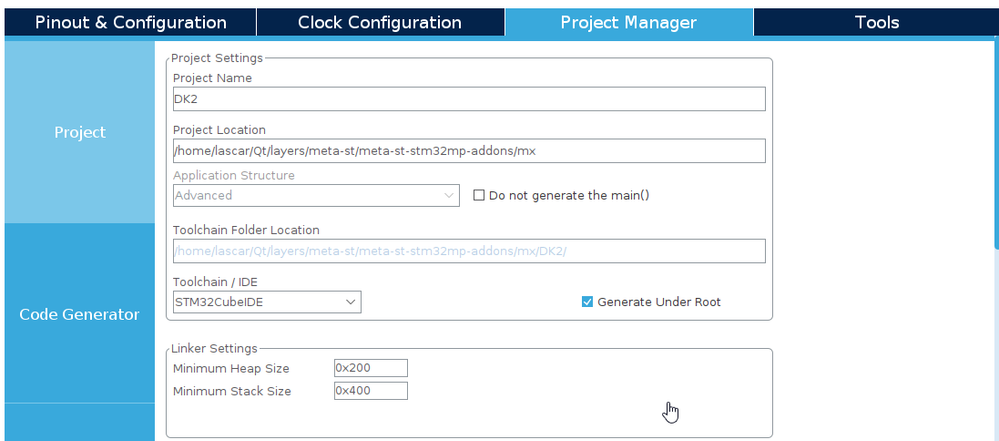

2022-02-22 1:04 AM
Hi @Kevin HUBER,
I didn't find any mistake by myself.
Could you help take a look? Thanks
Regards,
Leung
2022-02-22 1:09 AM
Hi @WLeun.3 ,
In the path expected by the build, the folder DeviceTree is before CA7, but in your environment, the folder CA7 is the first one.
I will check my configuration to verify If your configuration is the right one, or if it is the one from the recipe.
Regards,
Kevin

2022-02-23 5:27 AM
Hello @WLeun.3 ,
Please can you verify your variable CUBEMX_PROJECT from your .conf file of your MACHINE.
This variable must be set to the path where CubeMx generated the DTS.
In your case it must be:
CUBEMX_PROJECT = "mx/DK2/CA7/DeviceTree/DK2"The recipe that throw the error is: "layers/meta-st/meta-st-stm32mp-addons/classes/cubemx-stm32mp.bbclass", line 53
Regards,
Kevin
In order to give better visibility on the answered topics, please click on 'Select as Best' on the reply which solved your issue or answered your question. See also 'Best Answers'
2022-02-24 1:44 AM
Hi @Kevin HUBER ,
Yeah you are correct. Sorry that I have made such a silly typo mistake. I have fixed that accordingly.
