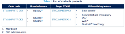

Hi @ARodr.18
There is two boards having different Bill of Material:
See https://www.st.com/en/evaluation-tools/stm32mp157f-dk2.html#overview or UM2637 for more details
Regards.
