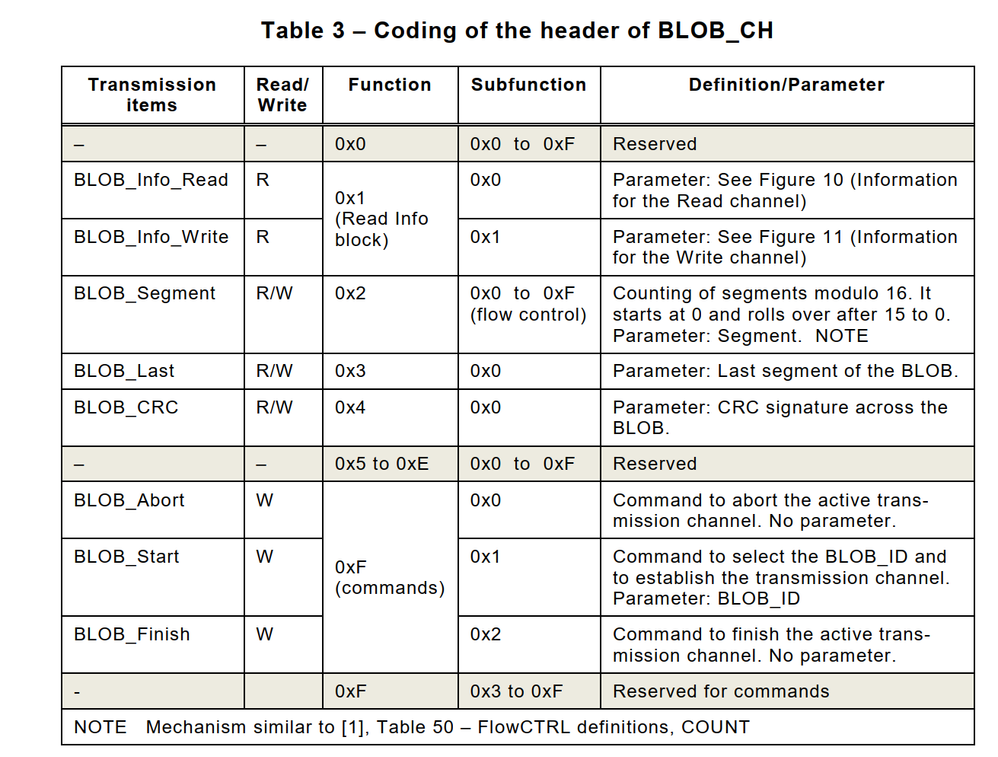

I use the BFA001V2 board as a counterpart for testing IO-Link Master with BLOB transfer. A problem was detected while reading a BLOB.
When using BFA001V2, after 15 successful data transfers (flow_control set to 0x2F), an invalid flow_control with a value of 0x30 (last frame) is sent. (However, the total size of the blob must be 16 KB!).
According to the IO-Link specification, flow_control should cycle from 0x20 to 0x2F, after almost all bytes have been sent, the Last_block command (0x30) should be sent with the last block of data.
Could someone check the stack on BFA001V2?
Thanks in Advance D.Krush
2023-09-26 2:07 AM
Dismis :)
Problem solved by the updating of the IO-Link Master Stack. Sorry.
