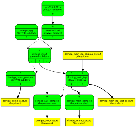

Hello @rdmikkelsen
Good work on bring up the probe. The behavior you observe is mostly correct now.
I have limited experience on image sensor driver, it is hard for us to guide you more on this, specially on the register or mode you want to implement.
However, now that you probed your sensor you should see it as a /dev/v4l-subdevX. What you need to do now is to tune the V4L framework to create your pipeline.
https://wiki.st.com/stm32mpu/wiki/STM32MP2_V4L2_camera_overview
You camera sensor should not be a /dev/videoX as it the output of our DCMIPP pipeline: see the chapter on topology
Try to configure the DCMIPP pipeline with V4L, if you encounter some issue we will try to help you.
Also, I recommend comparing the other camera sensor driver in linux/driver/media/i2c. The imx335.c will give you some hint on using v4l on driver side.
Regards
