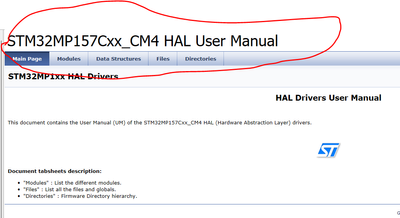

Hello all, good day I hope your Christmas season is going well. I'm looking for a pdf document equivalent of the PDF that is attached to this post that gives description for STM32MP157F-DK2 HAL and low-layer drivers or a HAL API Manual/Programming manual to program our STM32MP157F-DK2 board using STM32CubeIDE. I tried searching the internet for anything of the sort but I couldn't find anything for my STM32MP157F-DK2 board please provide kind support as soon as possible thank you best regards.
