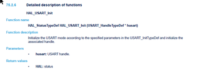

Hi @purushotham2608 ,
This is not equivalent since the .chm is an automatic generated documentation from code. It does contain not "human" made educational section as you can have in the .pdf.
Anyway, it document the same way all API functions :
eg USART_Init
.chm
.pdf
Note that most of generic "learning" chapter in the L4 pdf are likely applicable to STM32MP1 M4.
Differences to be cross-checked using .chm and code itself.
This is all we can provide as generic documentation. If you are still stuck finding some information, please be more specific in a dedicated post.
