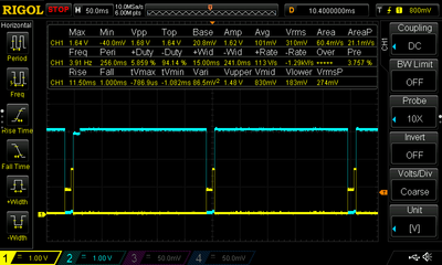

Having tried several possible workarounds—such as changing cables, reinstalling drivers and VMs, and reinstalling CubeProgrammer and the supporting software—I analyzed the USB_OTG (DRD) data lines with an oscilloscope. What I discovered is that the USB does not appear to exchange any data at all; instead, it repeats a peculiar "zero pattern" every 250ms. I have attached the oscilloscope printout: D+ in blue, D- in yellow.
This pattern appears only after a reset with the CN15 cable attached and connected to a PC. Otherwise, I get the blinking RED LD1 pattern.

Hello @Raggio ,
How do you power supply your board ? Through USB-C or through power supply connector ?
Can you well get Red and Greed LED on LD5/LD6 ?
Can you double check the boot pins are correct ?
Can you double check you have the necessary driver for ST-Link.
This DFU mode is massively used so maybe there is a little miss step hidden somewhere.
