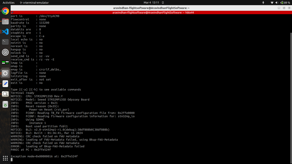

Hi, I was boot STM32MP135D-ODYSSEY with SD as boot option,using https://wiki.st.com/stm32mpu/wiki/STM32MPU_Distribution_Package and added odyssey dts. facing CRC check failed on FWU metadata and ERROR: loading of Bkup-FWU-Metadata failed. Can you help me with this. ----
~$ sudo picocom -b 115200 /dev/ttyACM0
picocom v3.1
port is : /dev/ttyACM0
flowcontrol : none
baudrate is : 115200
parity is : none
databits are : 8
stopbits are : 1
escape is : C-a
local echo is : no
noinit is : no
noreset is : no
hangup is : no
nolock is : no
send_cmd is : sz -vv
receive_cmd is : rz -vv -E
imap is :
omap is :
emap is : crcrlf,delbs,
logfile is : none
initstring : none
exit_after is : not set
exit is : no
Type [C-a] [C-h] to see available commands
Terminal ready
NOTICE: CPU: STM32MP135D Rev.Y
NOTICE: Model: Seeed STM32MP135D Odyssey Board
INFO: PMIC version = 0x21
INFO: Reset reason (0x35):
INFO: Power-on Reset (rst_por)
INFO: FCONF: Reading TB_FW firmware configuration file from: 0x2ffe0000
INFO: FCONF: Reading firmware configuration information for: stm32mp_io
INFO: Using SDMMC
INFO: Instance 1
INFO: Boot used partition fsbl1
NOTICE: BL2: v2.8-stm32mp1-r1.0(debug):38df888b0(38df888b)
NOTICE: BL2: Built : 01:36:41, Mar 15 2024
WARNING: CRC check failed on FWU metadata
WARNING: loading of FWU-Metadata failed, using Bkup-FWU-Metadata
PANIC at PC : 0x2ffe524f
Exception mode=0x00000016 at: 0x2ffe524f
