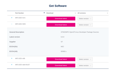

"I want to download the STM32MP2 Developer SW Package.
By visiting the page on the wiki (https://www.st.com/en/embedded-software/stm32mp2dev.html#get-software) and accessing the download link below, the file that opens is not 'SOURCE' but 'SDK(en.SDK-x86_64-stm32mp2-openstlinux-6.6-yocto-scarthgap-mpu-v24.11.06.tar.gz)'.
Where can I download the SOURCE?
My location is South Korea."

Hello @Kevin_Woo ,
On the st.com link you provided in your message, do you well see and take the package below ?
Called MP2-DEV-SRC.

Hello @Kevin_Woo ,
Called MP2-DEV-SRC.

Thanks for the reply.
I was always checking only "x86" and "arm" and not checking the required "src".
