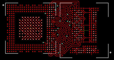

Hello, I am designing smartwatch with exactly same hardware, STM32MP157 with 04EM04_N3GM627 also from mouser. From electrical perspective it is possible, but you need to remember only TFBGA361 and LFBGA448 support 32 bit wide DDR due to pin constrains.
Your hardware is so similar that I'am considering if you want to talk about that and maybe help each other.
