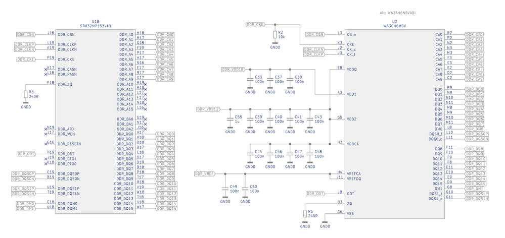

Hi @qyx ,
could you share your schematics around supply/ref/signals around DDR interface (both STM32MP15x and LPDDR3 side) ? Sometimes a fresh eye could find mixed up signals (we have the case from time to time).

2022-03-28 1:34 AM
2022-03-28 2:29 AM
Thank you for the reply, @PatrickF

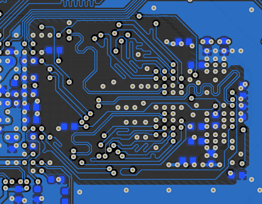

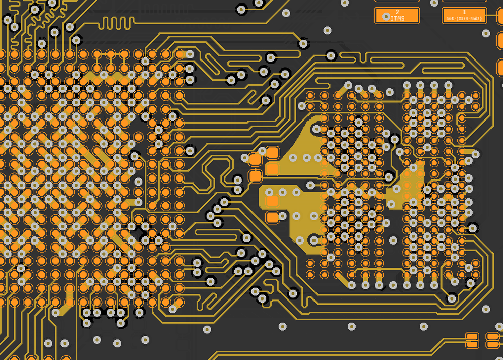

I have read the mentioned app notes, the only thing I overlooked is the 100R termination resistor on CLKN/CLKP. I added it directly on vias under the LPDDR3 chip now but still no luck.
Regarding the software, u-boot in the v3.1 ecosystem is very old. I was using the upstreamed support in the v2022.04-rc4. I will compare the changes to v3.1 ST's u-boot.
I am attaching the schematic cutout and routing. Individual tracks within byte lanes are matched to 0.1 mm, DQ0-7 is 18 mm, DQ8-15 is 16 mm, CA is 30 mm (the difference of 14 mm is a bit marginal).
Top layer:
Bottom layer:

Hi, you schematic sound ok. I assume the DDR_VREF is also connected to STM32MP15x.
I confirm the 100ohms on DDR clock was missing in AN5031 (but listed in AN5122 and in our schematics PCB examples).
Otherwise, I cannot comment more on SW version aspects as I have an HW focus.
2022-03-28 3:50 AM
Thanks for confirming the schematic is correct. Yes, DDR_VREF is connected to STM32MP15x too.
