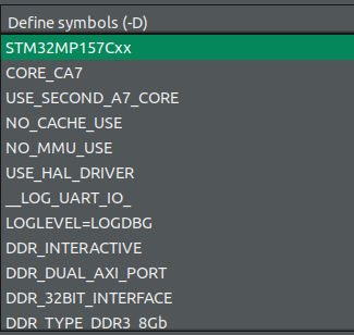

2023-04-19 11:10 AM - edited 2023-11-20 7:47 AM
Hi Patrick,
I try to compile ddr tool for M4 but printf not working for some reason.
I have my own custom board with changed UART4 debug ports and I2C4 different ports.
So I changed ports and pmic is configured well UART4 also but I see on the console only "DDR>" and I can provide some text like "step 3" but not see anything like DDR> and my texts. Of course, I assigned buttons and LEDs which seem to work
Reworking this firmware is a difficult task.
The preprocessor definition I used are
How to force to see printf

After taking and reworking project STM32MP!57C-DK2-DDR_UTILITIES_A7 something starts working.
So the result is as follow
for 8Gbit/16bits data width
