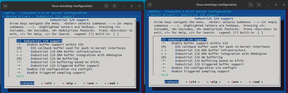

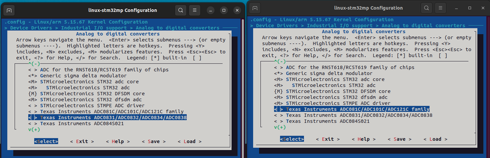

};In the Kernel configuration, I also marked
Device Drivers --->
<*> Industrial I/O support --->
Analog to digital converters --->
<*> STMicroelectronics STM32 adc core
<*> STMicroelectronics STM32 adcIt must be something I missed.

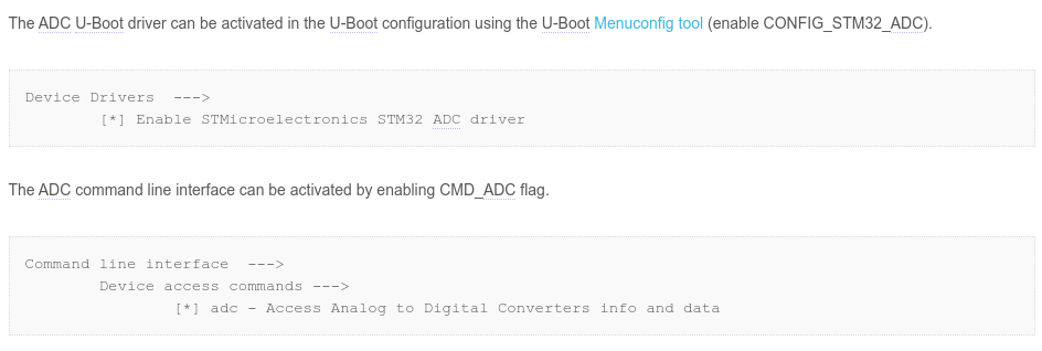

2023-03-17 8:10 AM
The configuration of both board
I can't find only the U-Boot drivers
Do U-Boot configuration (dts+driver) significant?
