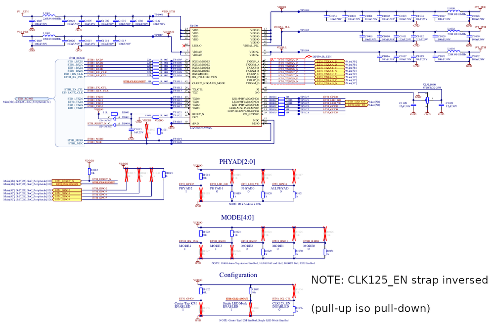

We have the idea that it is clock-tree related (See attached) .
The design is strapped so the PHY generates the clock-source (125MHz for 1GBit)
Some matching issues that we searched on the forum:
Relevant part of our schematics:

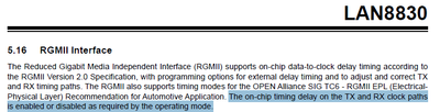

We have some design length differences in signals from Ethernet controller to PHY, which are a in pico second range and should be within limit of the PHY:
Signal length of lines & calculated delays

2024-07-23 7:28 AM - edited 2024-07-23 7:29 AM
Update after some investigation

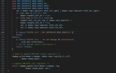

1. We have modified our board (reverted basically) to NOT use the 125MHz from the Phy. We have enabled in TF-A & OP-Tee the
CLK_ETH_PLL4P
which is configured for 125Mhz via the HSE (24MHz) divmn = <3, 124>; st,pll_div_pqr=<5 7 7>;
2. In Kernel DTS we enable the st,eth-clk-sel so taht in dwmac-stm32.c during 'stm32mp1_set_mode' in RGMII mode the enable_eth_ck is activated. We have briefly checked with 25Mhz clock but that doesn't seem to work (get DMA issues reported in dmesg again).
(Relevant) Dmesg output:
root@wesl:~# dmesg | grep eth -i
[ 0.000000] psci: probing for conduit method from DT.
[ 0.269579] pegasus: Pegasus/Pegasus II USB Ethernet driver

Status;
Anyone with hints / tips what to check?

maybe a basic info:
For RGMII, did you enabled the ~2ns delay on RX and TX inside the PHY (sometimes it is thru HW config, sometimes thru MDIO SW control with device tree) ?
Regards.
2024-07-23 8:08 AM
Thanks @PatrickF .
We have not set any delay specifically. we just copied the implemenation from the DK boards.
Also not sure if the path differences is wrong, according to the datasheet it is below <1ns differenence, therefore not a problem? but we can test if you give me some more info.
What we do notice, and are not sure about is the difference in TX and RX clock. We see in Linux that the RX and TX clock have different sources (and frequencies), and also when we measure them they are significantly different.
The RX clock is a nice 125MHz clock, but TX seems to be jittering all over the place (or we cannot measure it correctly).
2024-07-23 8:24 AM
delay on RGMII is a must, it could be either on GMAC or PHY side, but as STM32MP1 does not have embedded delay on neither RX or TX direction, it must be enabled on the PHY side for RX and TX (depend on the PHY driver I guess).
Regards.
