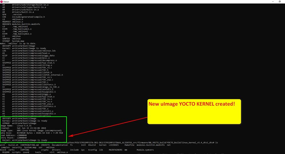

Hello all friends,
a beautiful day today!
A first uImage KERNEL Linux YOCTO STM32MP157 board image has been generated, it is only a first generation test but the cross compiler did not throw errors:
this guide was fundamental (Chinese, right click automatically translate from Browser please):
https://www.bilibili.com/read/cv11484220/

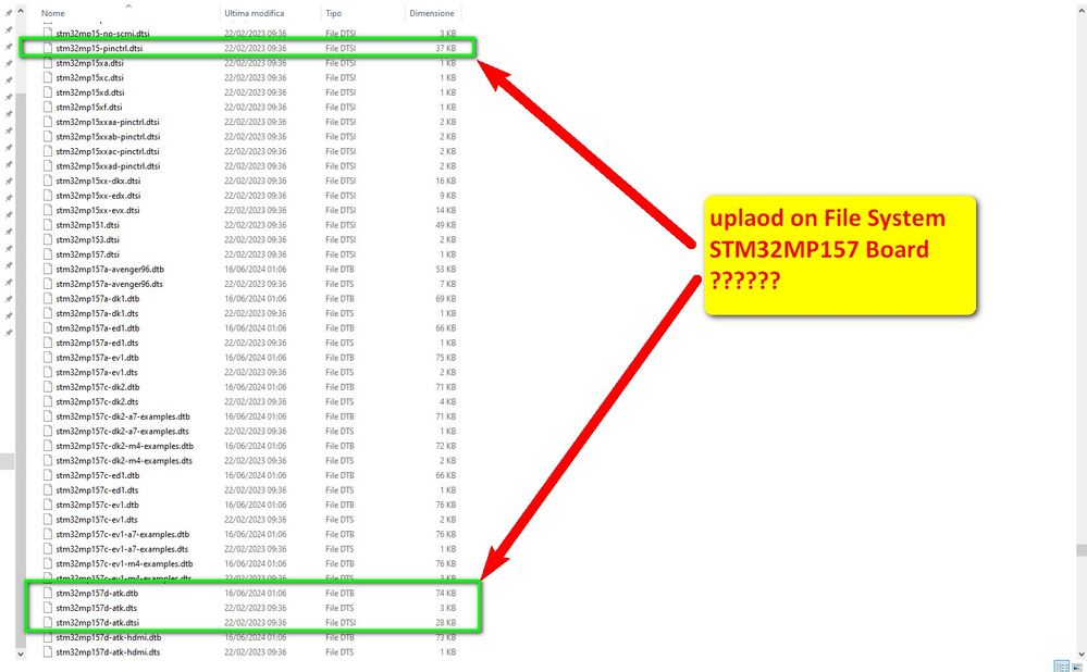

Now what needs to be done:
1) uImage (local pc):
uImage should be loaded on the File System of the STM32MP157 board in /boot or in which path??
2) DEVICE TREE FILES MODIFIED (local pc)
NOTE: I remember the modified device tree files are the following (see ADC MULTIPLEXING manual EN on page 52:
- stm32mp15-pinctrl.dtsi
- stm32mp157d-atk.dtsi
Which device tree files should be loaded onto the File System of the STM32MP157 motherboard and where should they be loaded in which path??:
- stm32mp157d-atk-hdmi.dtb (???)
- stm32mp157d-atk-hdmi.dts (???)
- stm32mp15-pinctrl.dtsi (???)

Hi @bass34
I'm not expert and not knowledgeable on the board you are using, I will try to help you on that topics:
1) please have a look to https://wiki.st.com/stm32mpu/wiki/OpenSTLinux_directory_structure
2) please have a look to https://wiki.st.com/stm32mpu/wiki/STM32_MPU_device_tree
3) those should help:
https://wiki.st.com/stm32mpu/wiki/ADC_OpenSTLinux_drivers#Linux_kernel_driver
4) I did not fully understand your concern, with Yocto and embedded Linux systems, you should (and you must) generate a customized full image of all the eMMC partitions (in order to being able in production to flash blank boards using STM32CubeProg or else), so backup is not a concern as eMMC image is already on your PC.
Regards.
