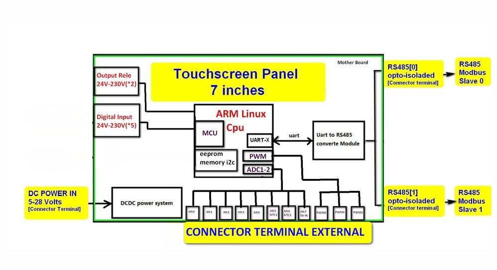

ADC1+ADC2 - Analog Multi channel IO
DEVICE TREE

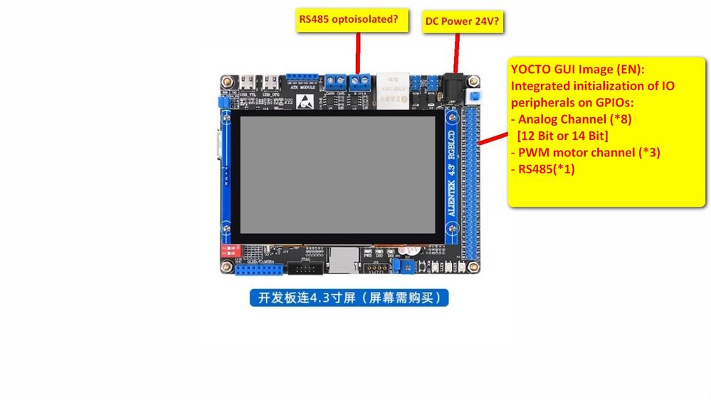

It is essential to create from device tree :
- 8 ANALOG type GPIO physical pins on the board (AN0,AN1,AN2, AN3,AN4,AN5,AN6,AN7)
- 3 GPIO physical pins of PWM type real time motors on the board (PWM0, PWM1,PWM3)

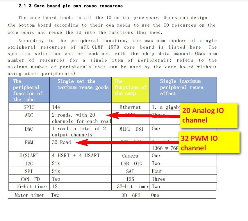

But manufacturing company says only 2 ADC pins can be read,
I attach STM32MP157 MINI mapping:
STM32MP157DAA1_1G-RAM _ 8GB-eMMC - Datasheet
But the powerful SOM BOARD STM32MP157DAA1_1G-RAM _ 8GB-eMMC clearly specifies 22 multiple IO Analog channels on ADC1 and ADC2 and 32 multiple PWM IO channels:
Please multiple control of 8 analog sensors and 3 PWM sensors (motor control) in Linux is fundamental for my machine control project from Linux CPU, that's why I chose the powerful STM32MP157 MINI board from alintek (STM32MP157DAA1_1G-RAM _ 8GB-eMMC)

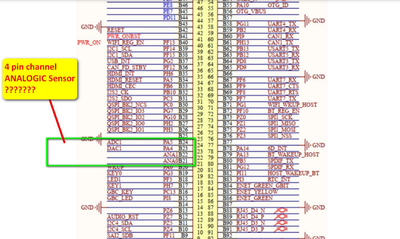

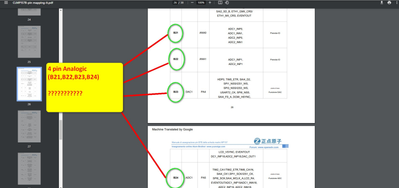

the manufacturer responded Alientek simply by sending the pin mapping of the motherboard saying that only 2 GPIO PINS can be used to read channels and therefore only 2 analog sensors B23 e B24:
while their data sheet of their assembled SOM CORE Board STM32MP157DAA1_1G-RAM _ 8GB-eMM clearly talks about ADC1 and ADC2 on which up to 22 analog channels can run, I am very angry now and confused:

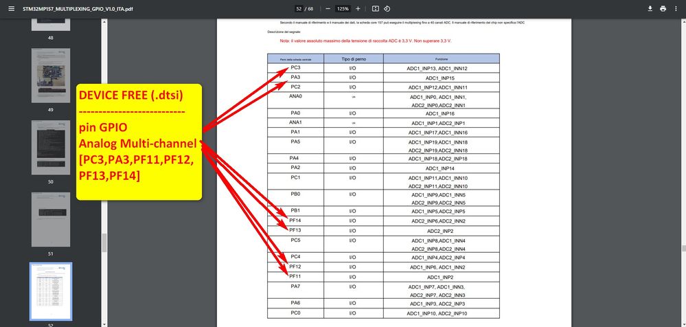

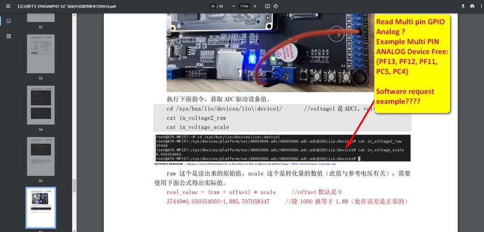

The manual for MULTIPLEXING GPIO pins has arrived and I attach it here on topic,
but it is not clear how to create a new .tsv file of the new firmware

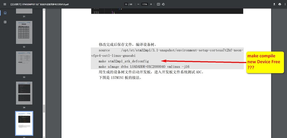

1) after modifying the dtsi files of the KERNEL source device tree (mapping of the new 6 GPIO pins as Analog INPUT) how to create a new firmware .tsv file?
Should these 3 commands for compiling the new device tree be executed via ssh directly on the file system of the STM32MP157 MINI board?
1)source /opt/st/stm32mp1/3.1-snapshot/environment-setup-cortexa7t2hf-neonvfpv4-ostl-linux-gnueabi
2) make stm32mp1_atk_defconfig
3) make uImage dtbs LOADADDR=0XC2000040 vmlinux -j16
2) The software to read the analog voltage on a specific GPIO PIN as per the MULTIPLEXING manual on page 56 is performed by calling together device 1 (entire ADC1 voltage) and device 2 (entire ADC2 voltage), but in the case of 6 pins GPIO separated and configured on ADC1 and ADC2 how do you read the analog voltage on the individual GPIO pins separately and independently:

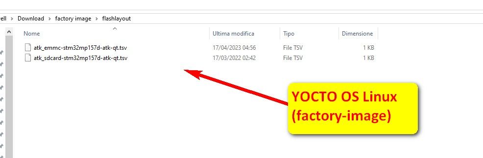

The YOCTO factory image of the STM32MP157 is a .tsv:
The MULTIPLEXING STM32MP157 MINI powerful board manual says that after editing the .dtsi files:
"Once you have completed editing the files, save the file and compile the device tree by indicating these commands MAKE Compile":
1) but where should they be launched on the STM32MP157 MINI board or on the compiler PC?
2) how to create a new .tsv file with compiled analog GPIO multi pins?
