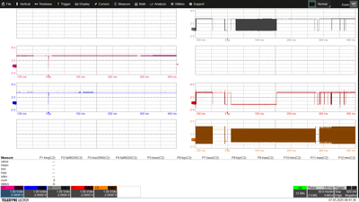

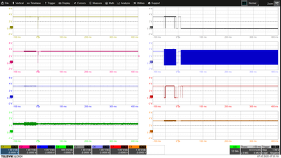

In addition, we measured some signals with a scope during reboot:
REV0200 (reboot works)
CH2: NRST // CH3: NRST_CORE // CH5: DAT0 (EMMC) // CH7: CMD (EMMC) // CH8: CLK (EMMC)
REV0300 (reboot isn't working)
CH1: NRST // CH2: NRST_CORE // CH3: PWR_ON (MPU) // CH4: VDDCORE (1.2V) // CH5: CMD (EMMC) // CH6: CLK (EMMC) // CH7: DAT0(EMMC) // CH8: VDD (3.3V)
It looks like the STM just held CMD low because there is a timeout or hanging during Boot-ROM.
