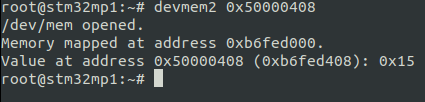

Once you use devmem, you get the value like this:
Then you interpret this value by using the reference manual that details all the possible values: https://www.st.com/resource/en/reference_manual/rm0436-stm32mp157-advanced-armbased-32bit-mpus-stmicroelectronics.pdf#page=996
