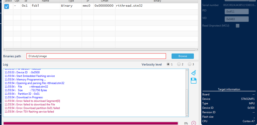

I recall that ST is not supporting any bare solution but only Linux for A7 in its ecosystem.
Anyway, if I assume rtthread.stm32 is a bare code for A7, you can't load it into mmc0 ( SDCard) with the single line TSV I see in screenshot.
The minimal TSV might be (for a DK board ) :
#Opt Id Name Type IP Offset Binary
- 0x01 fsbl1-boot Binary none 0x0 arm-trusted-firmware/tf-a-stm32mp157c-dk2-usb.stm32
- 0x03 fip-boot Binary none 0x0 fip/fip-stm32mp157c-dk2-trusted.bin
P 0x04 fsbl1 Binary mmc0 0x00004400 rtthread.stm32This load in DDR Tf-a and U-boot enabling DFU service to flashload the fsbl1 paritition in SDCard.
Hope it help,
Olivier
