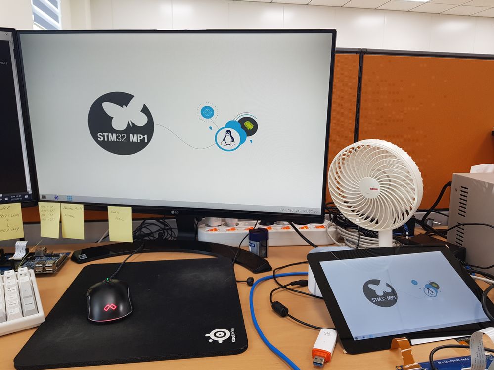

I have a question regarding dual display.
I want to display same content at the same time to both display devices (LTDC and HDMI).
But, As my understanding, STM32MP1 has only one display controller.
https://community.st.com/s/question/0D53W00000DH4AqSAL/can-i-use-dual-display-on-stm32mp157c-chipset
My TFT-LCD's resolution is 1280x800 (10.1inch) and support LVDS.
So, if I can implement dual display, LCD and HDMI will has same resolution.
Isn't there any solution to implement dual display implementation?

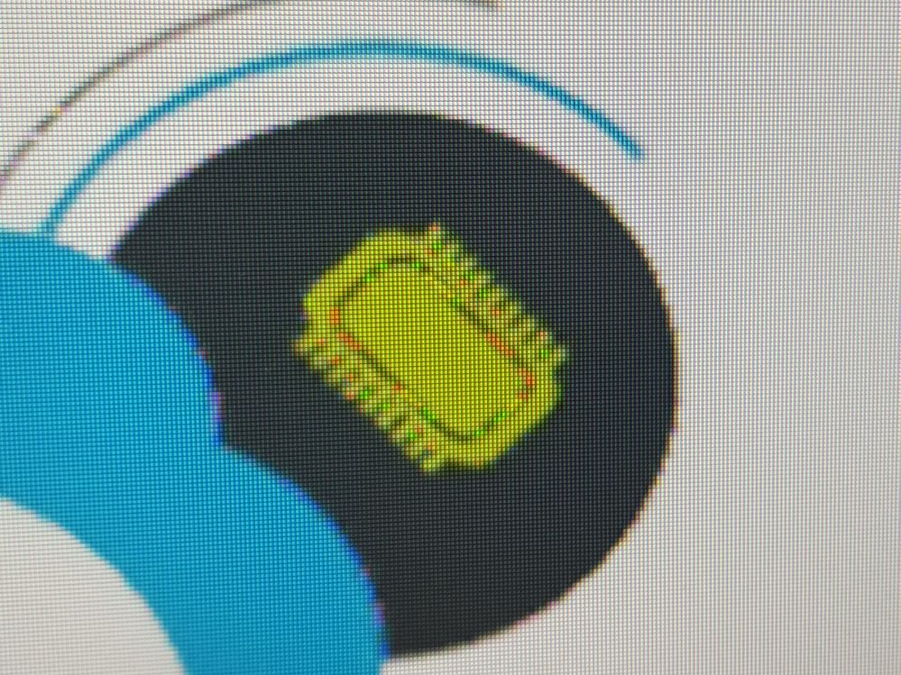

Actually, I tried the following.
As a result, both display devices can be display same content at the same time.
But there is one problem that display quaility is not clearly.
And both display devices has exactly same quality.
To be honest I don't know exactly that this application is right.
Can I get some advice?
Thanks regards
2022-09-29 1:01 AM
I solved this problem.
I changed all of LTDC pin`s maximum output speed to Very High in the CubeMX.
Now both display quality are very clearly.

2022-09-29 1:01 AM
