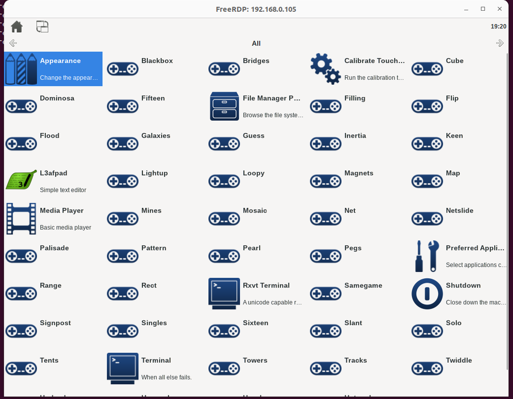

2025-08-26 6:47 AM
After trying some more time. I switch from Weston RDP to X11 RDP, now i got it run in first-time

systemctl restart sshd.socketNow from PC connect through RDP using xfreerdp
xfreerdp /v:<ip of board> /u:<user> /p:<password> /dynamic-resolution /cert:ignore
