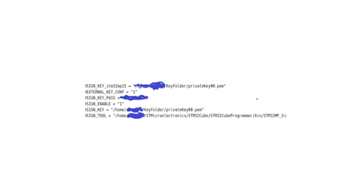

2024-07-30 12:44 AM
Hi Kevin,
I already have it enabled in my yocto build as shown below but the error persist.
Kind regards,
Basit
2024-08-07 6:33 AM
Hello @ao2-yekeen ,
This should normally works. I will give it a try on my side and see if it works.
Just to be sure, in the screenshot that you shared, it looks like there is "#" at the beginning of each lines. Which means that the lines are commented in the "local.conf" and therefore not taken into account.
Can you confirm that they appear without the "#" at the beginning of the line in the configuration file?
Or if you can share the whole local.conf file (without the passkey).
Best Regards,
Kevin
