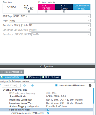

Hi, it was the DDR configuration file generated by CubeMX. Tried relaxed timings and it now works. But now I have another problem regarding i think u-boot. With 256Mb RAM i get the following error just before loading the kernel:

2023-09-21 6:05 AM - edited 2023-09-21 6:05 AM
Very interesting , where to set to relax those timings ? My 512MB board runs fine with ECO 1, but still have AXI 480 error with ECO 5.

2023-09-21 5:26 PM
Thank you so much. It would be a bit surprising if this fixes the AXI violation issue. In case of DDR timing issues, one would expect random type of errors in different DRAM locations than a consistent error at the same memory address. It would be more likely to be related to the initialization of the memory ranges of the tzc400. But you never know. will try this !
2023-09-21 8:21 PM
Did not work for me. Same error.

relaxed:
#define DDR_DRAMTMG0 0x131B1215
#define DDR_DRAMTMG1 0x000A051D
#define DDR_DRAMTMG2 0x06080A10
#define DDR_DRAMTMG3 0x0050400C
#define DDR_DRAMTMG4 0x09040709
#define DDR_DRAMTMG5 0x06060403
#define DDR_DRAMTMG6 0x02020002
#define DDR_DRAMTMG7 0x00000202
#define DDR_DRAMTMG8 0x00001005
#define DDR_DRAMTMG14 0x000000A0
w/o relaxed:
#define DDR_DRAMTMG0 0x121B2414
#define DDR_DRAMTMG1 0x000A041C
#define DDR_DRAMTMG2 0x0608090F
#define DDR_DRAMTMG4 0x08040608
