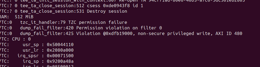

Hi, i get this error when uboot starts on custom MP153D board:
E/TC:0 tzc_it_handler:79 TZC permission failure
E/TC:0 dump_fail_filter:420 Permission violation on filter 0
E/TC:0 dump_fail_filter:425 Violation @0xdff09000, non-secure privileged write, AXI ID 480
Can someone point me in the right direction? I cannot find a correspondence for AXI ID 480 in order to inverstigate over.

Hi, just compiled from downloaded sdk. I think it could be a RAM related issue. I tried the same configuration on a board with 256Mb (2Gbit) 16 bit DDR3 module (only the RAM capacity changes) and got AXI ID 4a0 error. Then I set a new ram configuration in CubeMX and now it runs OK. For the 512Mb (4Gbit) DDR3 module i still get AXI ID 480 error. I cannot find a valid configuration setup, neither I can use the bundled 1x4Gb dtsi. The RAM module is from the same family of the 2G one, same datasheet and same timings.

Attached the boot log.
