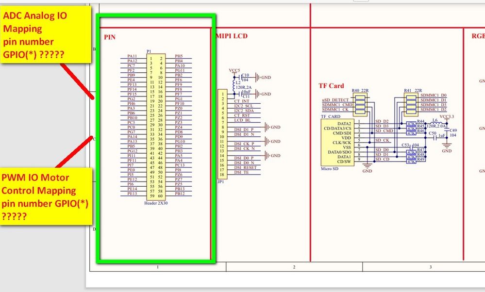

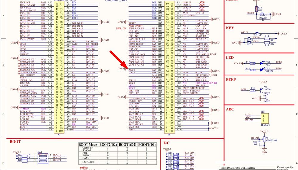

Hello everyone, if you can help me it's urgent.
Here I have a powerful Linux board development platform STM32MP157-MINI Linux Board,
CORE: STM32MP157DAA1_1GB-RAM_ 8GB-eMMC_CORE_BOARD_SOM
src
I have these files in the src folder BOARD MINI but I don't understand how to build an image with the multi-channel mapping of the analog IO and PWM IO on the board on the external GPIO pins of the board, there is a bash script to quickly map Analog and PWM pins on the STM32MP157DAA1_1G- board RAM _ 8GB-eMMC or other fast technique?
Necessary to build image YOCTO whith integrate Mapping PIN Analog and PWM Motor:
1) YOCTO GUI image Fast boot system Fast system (boot system in less than 10 seconds with GUI and systemd and WiFI active on the card)
2) mapping on external GPIO pins at least 6*Analog channels for reading analog actuator sensors
3) mapping on external GPIO pins at least 3*PWM channels for real time motor control
Thank you in the meantime for your precious help
