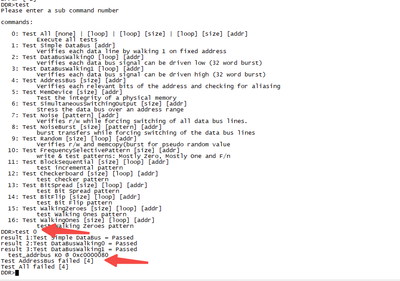

hello,my custom board use the same ddr as STM32MP135F-DK board. but when I debug the example DDR_Init_A7.erro occus when verify data in address 0xc0000000 + 0x80。as show in picture.pls help me

DDR range:0xc0000000 --->0xc0000000 + 0x80  is ok. so i think routing has no problem.but i could no understand why   0x80---->512M   have problem
and DDR_TEST as follow:
