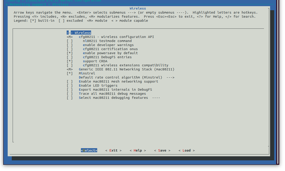

Besides the device tree and the above mentioned device drivers I can share my Network support -> Wireless settings (see picture).
