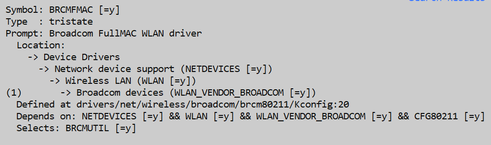

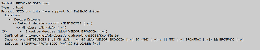

for the On-Chip wifi module of the STM32MP157c-dk2 you must enable the broadcom FullMAC WLAN driver and its SDIO bus interface (the brcmfmac module is used) in the linux-menuconfig.

Activated Broadcom FullMAC WLAN driver as module ( <M>)
Activated SDIO bus interface support for FullMAC driver

you dont have to download any driver manually. The linux driver configuration seems fine to me.
The wifi chip needs a firmware to run too. That one you will get by activating it in the buildroot menuconfig. I assume you did that according to how your bcrm folder looks.
Waht does
ifconfig -a
say? Can you see the wlan0 device there? If you can see it there it is only a wpa_supplicant / interfaces configuration. Didn't test it that far but you will find a lot of examples and information in the web. I know of two people that got it working though.
