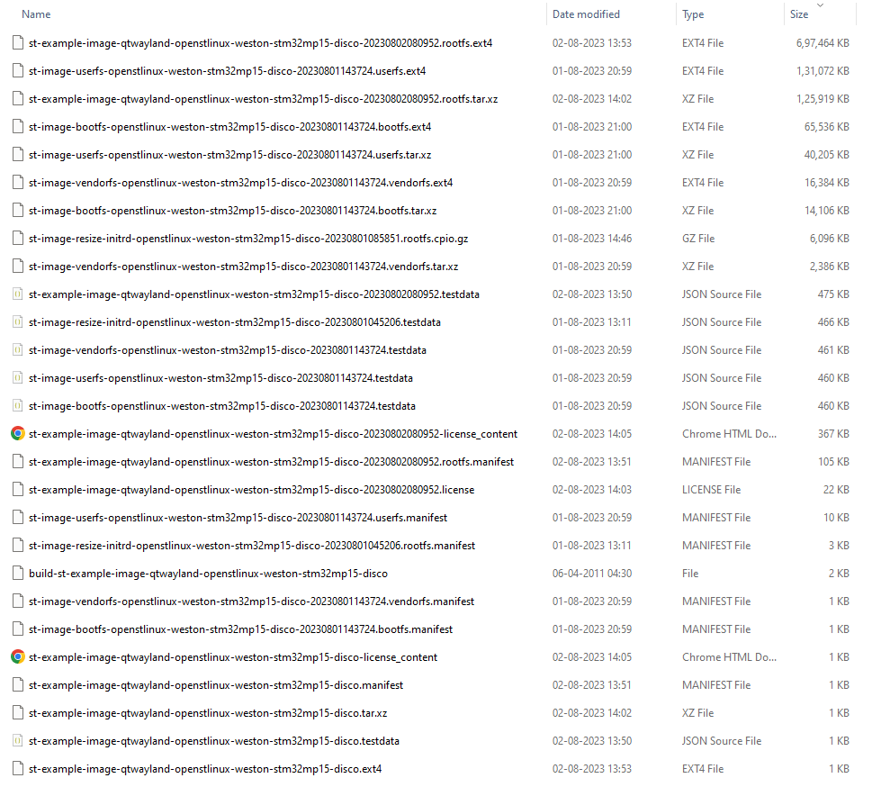

I'm looking at the tmp-glibc/deploy/images/stm32mp15-disco/ directory and I am unable to figure out which of these I need to flash on to the SD card using etcher on my PC.
Could someone help point me in the right direction?

Here you are supposed to have a flashlayout_st-example-image-qtwayland folder, containing optee folder and itself containing the different TSV files that have been generated if everything were going well in your compilation step. This TSV file can be directly used with CubeProgrammer following Wiki information, or you can use the script located in tmp-glibc/deploy/images/<st_platform>/scripts as follows:
./create_sdcard_from_flashlayout.sh ../<your_flashlayout>/optee/<your_TSV>
I hope it will help you to go forward.

2023-08-02 5:46 AM
Thanks Erwan!
This did the trick.
