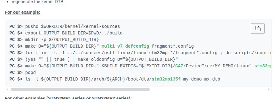

Hi @PatrickF,
I reviewed the document you shared and followed the steps as described. However, when building the external kernel DTS, I’m encountering the following issue.
with this reference:
I’m running the command:
make O="${OUTPUT_BUILD_DIR}" \
     KBUILD_EXTDTS="${EXTDT_DIR}/CA35/DeviceTree/MY_DEMO/linux" \
     stm32mp257f-mydts-mx.dtb
And the build fails with:
make[3]: *** No rule to make target 'arch/arm64/boot/dts/stm32mp257f-mydts-mx.dtb'. Stop.
make[2]: *** Makefile:1409: stm32mp257f-mydts-mx.dtb Error 1
make[1]: *** Makefile:234: __sub-make Error 2
make: *** Makefile:234: __sub-make Error 2
It seems the compiler is trying to locate the DTB at:
My question is:
If I’m invoking the build with KBUILD_EXTDTS pointing to my external DTS directory, how is the kernel expected to generate this file under arch/arm64/boot/dts/?
Is there an additional Makefile entry or naming requirement that I might be missing on the external DTS side?
Thanks for your guidance.
