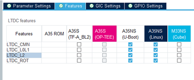

I have successfully resolved the issue, thank you.
To enable the display, it's necessary to configure both LTDC_CMN and LTDC_L2 in U-Boot and Linux.
