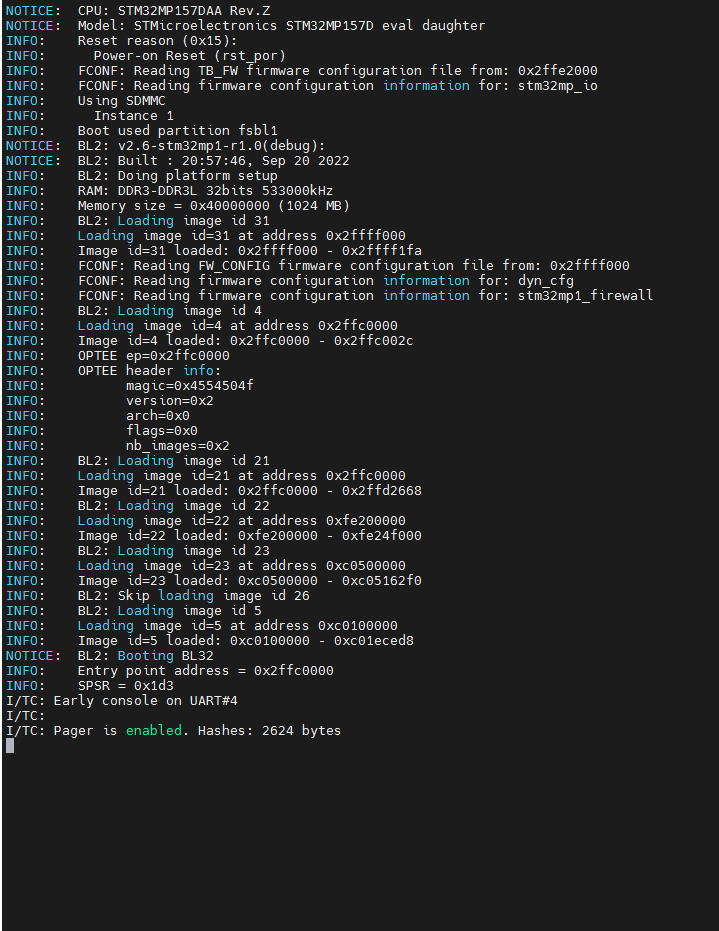

When I use sp_ min, I use the following command to generate fip in the Bareenvironment, and can start the u-boot normally:
fiptool create --tos-fw bl32.bin --nt-fw u-boot-nodtb.bin --fw-config stm32mp157d-***-fw-config.dtb --hw-config stm32mp157d-xx.dtb --tos-fw-config stm32mp157d-***-bl32.dtb fip.bin
But when I use OP-TEE, I use the following command:
fiptool create --tos-fw tee-header_v2.bin --tos-fw-extra1 tee-pager_v2.bin --tos-fw-extra2 tee-pageable_v2.bin --fw-config stm32mp157d-***-fw-config.dtb --nt-fw u-boot-nodtb.bin --hw-config u-boot.dtb --tos-fw-config stm32mp157d-***-optee.dtb fip.bin
The result is that can't enter the u-boot,stuck somewhere, I don't know whether there is a problem with the configured op-tee system or the generated fip method is wrong?
Please take a look.
Thank you very much.

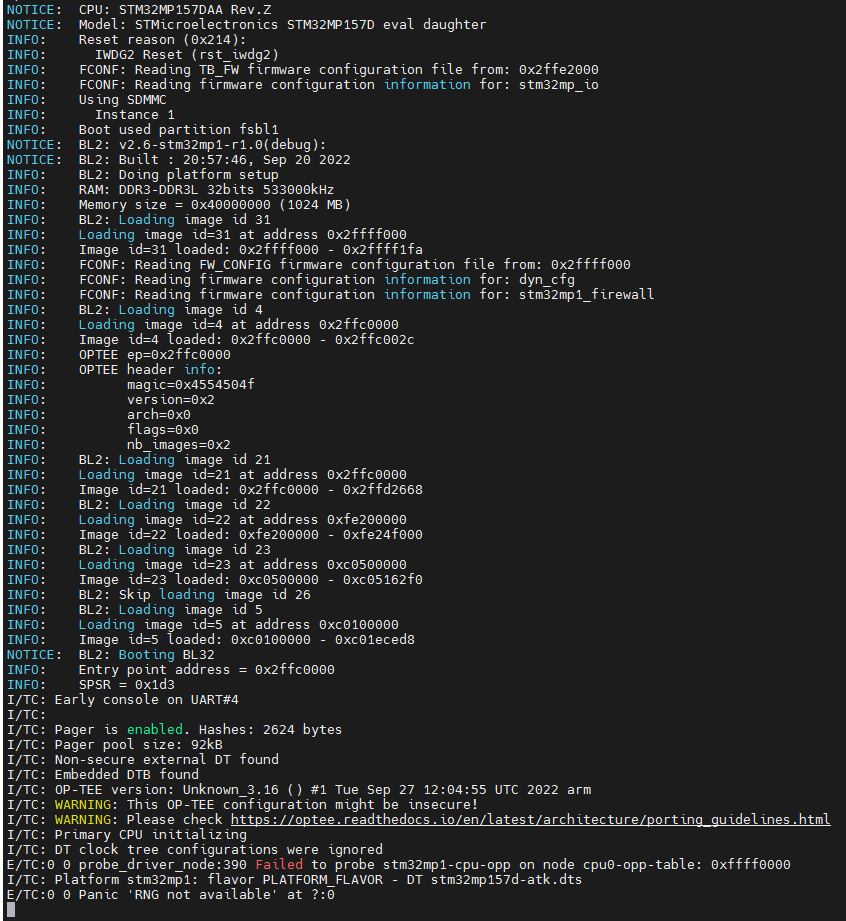

Did you enable the RNG in DT optee? All regulators (regulators-fixed) should also be in declared in OPTEE DT board
I don't have a DT file in discrete power supply configuration as reference. But some SOM maker partners have done so already on previous OSTL DV

Which OSTL distribution you use? Did you compile OPTEE with your board? Sounds like the TF-A FW_Config address doesn't match the one in OPTEE. Otherwise you need to enable DEBUG trace in OPTEE to see what's going on.

Thank you for your reply. I fixed the DDR size setting, but a new problem occurred later:
Is it because the power supply I use is fixed?
There is no PMIC on my board

@ssw.1Did you solve this? I'm having the same problem (minus the RNG not available message):
E/TC:0 0 probe_driver_node:413 Failed to probe stm32mp1-cpu-opp on node cpu0-opp-table: 0xffff0000
