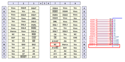

However, on the DDR datasheet, pin M7 is marked as NC (No Connection), but on our PCB, M7 is connected to A15 (Address 15). Could this pose a problem?
2024-07-30 12:32 AM
I don't think this is the issue as A15 is available on JEDEC to support larger density.
If behavior depend on timing setup, there is likely something weird around the memory (routing, supplies, voltage references, etc..).
We have seen DDR3L quite robust on customer design, so the issue is probably easy to detect.
