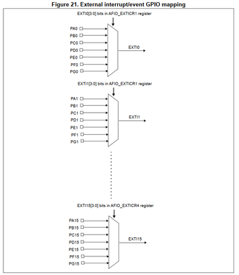

2023-08-02 7:22 AM
Hi @PatrickF,
your answer has been super useful to me too! Many thanks!!!
In the datasheet is not reported that "only one line" can work at the time. From the picture looks like that the EXTIx is shared across all these inputs (PA0, PB0, PC0, ...).
I also found some misleading webpages on this topic, so an official document would be definitely help!
