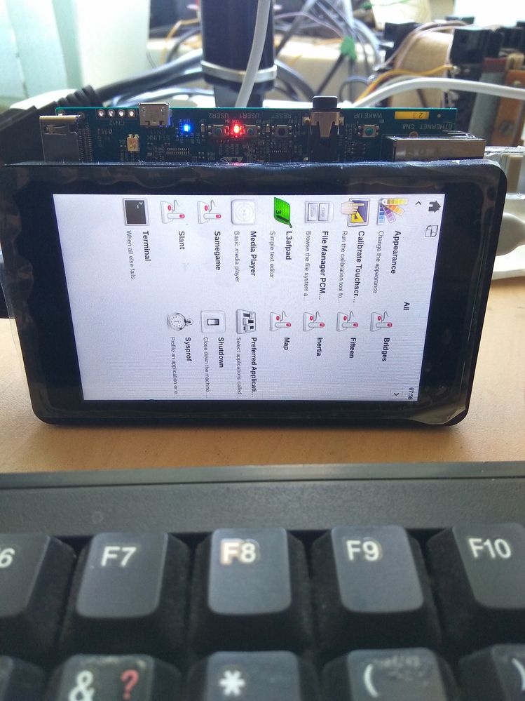

I installed st-example-image-x11.
Matchbox windows manager started on foto.
And ! have 2 problem. Till.
1st problem.
I can not change the orientation of the matchbox panel. I changed the lines in the /usr/bin/matchbox-session file: matchbox-panel --orientation south
but the screen orientation has not changed

2020-09-08 1:29 AM
I had some problems with the display on the MP157C-DK2 with orientation, character recognition, etc.
I calibrated display, read the posts. etc. But the problem was that the connector between the display and the board has moved a bit from its proper position. It happened when I was accessing the GPIO pins on the CN2.
I re-inserted the connector and it started to work fine again.
