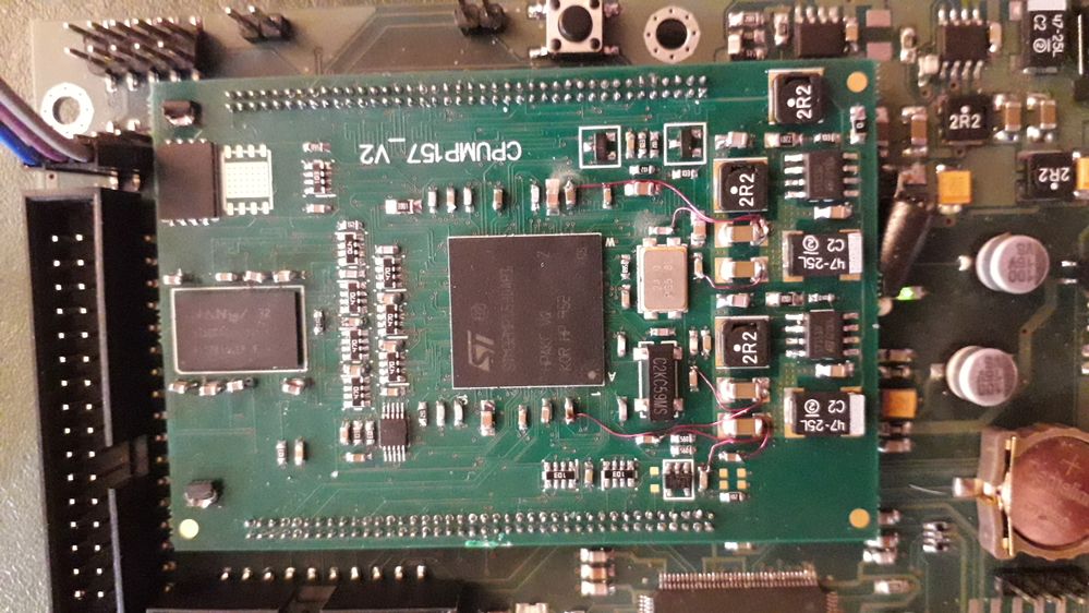

Latest bare-metal Cortex-A7 news:
Added EHCI controller support (trough slightly modified for speed ST USB HOST Middleware).
No HUB support now.
Results of write speed on directly connected USB storages, exFAT, 128 kB blocks in one minute run:
USB FLASH 8GB: Write speed 5332 kB/S
SATA HDD (old 120 GB 5400 rpm Hitachi HTS542512K9SA00 on USB->SATA converter): Write speed 38637 kB/S
Source codes in my GitHub repo
