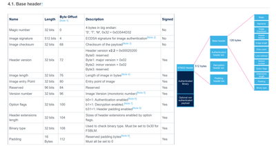

We are working on booting BareMetal application using SD Card in STM32mp257F-DK
we have referred the following link to create header for binary file
https://wiki.st.com/stm32mpu/wiki/STM32_header_for_binary_files
we have few doubts regarding the above image:
1) In optional flags, can we disable authentication and decryption
2) In binary type, what are the other formats other than FSBLM. In tf-a-stm32mp257f_dk_usb.stm32 file the binary type is mentioned as 0x10 is used, what binary type is it? In STM32MP157A we have set the value of binary type as 0x00 but it still boots our application.

STM32MP2x uses header v2.2.
You should use https://wiki.st.com/stm32mpu/wiki/Signing_tool to add header to your binary file.
Command line of Example7 should be ok for you.
