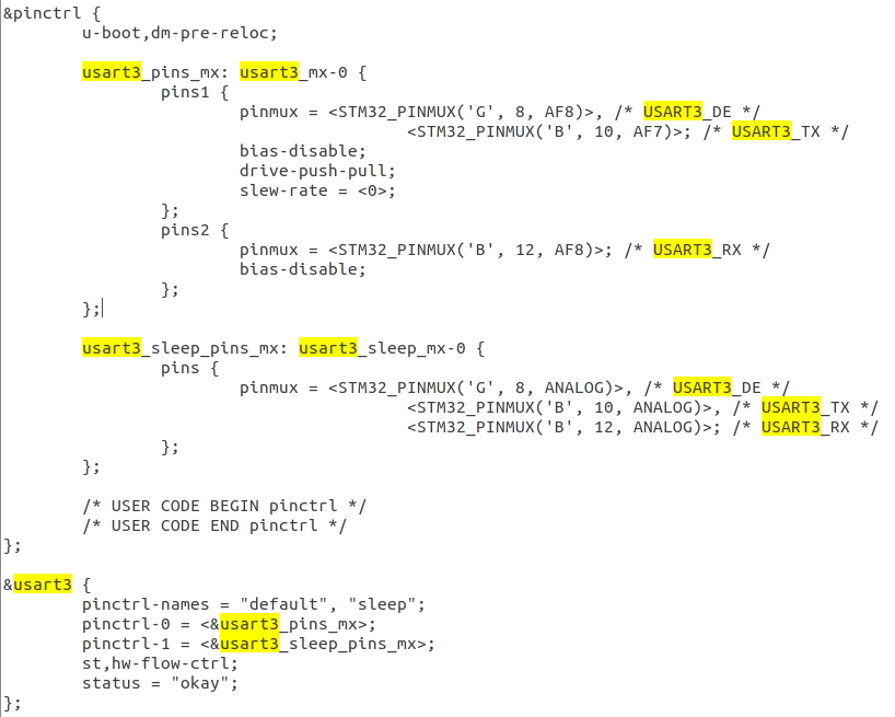

I am using the STM32MP157C-DK2 board. I fixed the stm32mp157a-dk1 file as shown below
Generated the device tree blobs (* .dtb) and updated the device tree blob on the board.

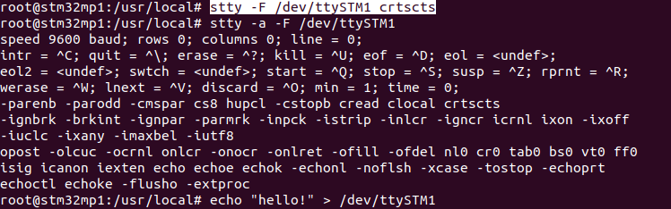

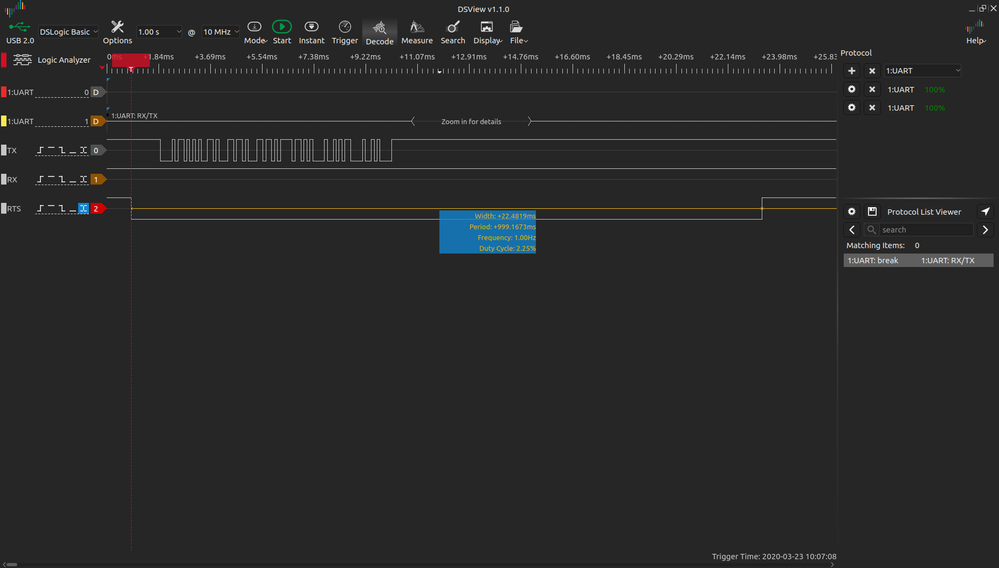

I sent an echo "hello!" > /dev/ttySTM1

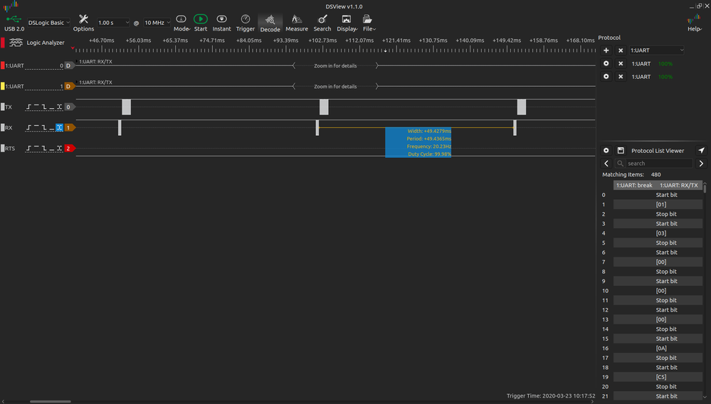

and I see that the RTS pin is held for too long, I think that this pin is held all the time while the file is open by the operating system.
Then I launched the Modbus-RTU test application. reception and transmission work correctly, but the RTS pin does not switch. The RTS pin was pressed to the ground when I launched the application and released when I closed the application.

As first assumption your problem looks similar to this post :
https://community.st.com/s/question/0D50X0000BQOvVxSQL/cant-get-the-rts-line-working-on-stm32mp1-in-linux-stm32mp157cdk2
"st,hw-flow-ctrl;" properties missing in your Device Tree ?

Hi OlivierG (ST Employee)
yes i saw this post
yes, it was seen in my question

I did as it is written here: https://wiki.st.com/stm32mpu/wiki/Serial_TTY_device_tree_configuration#Activation_of_a_USART_or_UART_instance and https://wiki.st.com/stm32mpu/wiki/How_to_use_TTY_with_User_Terminal#Purpose
Reception and transmission are working correctly, but the RTS output is not working properly. this can be seen in the screenshots in my question
