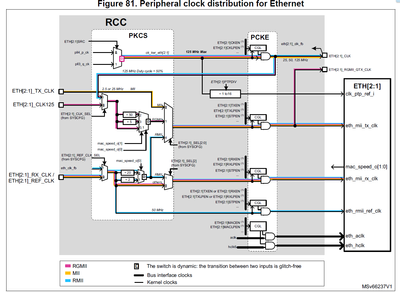

you should setup the 'magenta' clocking path to use 125MHz root from PHY (CLK_125 pin) .

Have you carefully checked the RM figure related to ETH clocking (see this previous post) and confirm your settings inside SYSCFG_PMCSETR and RCC are ok to have clock going to GMAC.
You probably need to check:
- ETH1_SEL[2:0]=1 for RGMII
- ETH1_CLK_SEL = 0 if 125MHz clock come from ETH1_CLK125 pin (from PHY),
or 1 if coming from PLL (RCC should define PLL4 or PLL3 as well as correct ETH1_SRC to ensure 125MHz clock path is ok)
- ETH1_REF_CLK_SEL = 0
- all GMAC clocks are enabled in RCC

Yup, RGMII selected in ETH1_SEL[2:0]. Prepped it for ETH2 as well. ETH1_CLK_SEL is set to 0, though for fun I've tried 1 as well with PLL4 set up to provide the clock. GMAC clocks... I don't see any in RCC. Am I missing something?
