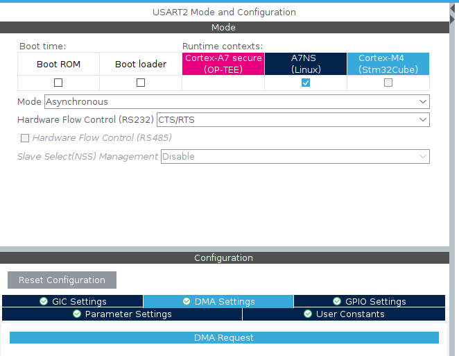

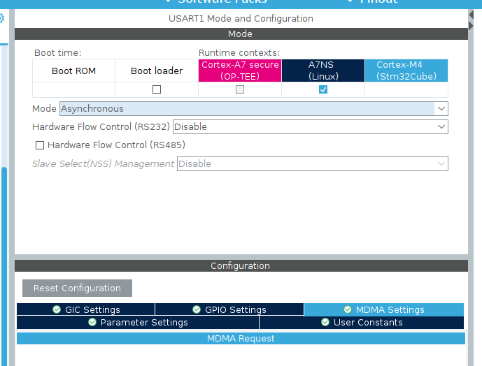

You can see that by using CubeMX, for USART1 only a tab MDMA Settings is available:
When for the other USART like USART2, you can see a DMA Settings tab:
