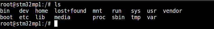

1. How can I further organize my desired directory in the area shown in the photo below?.
I want to configure separate directories for my application and scripts.
2. How do I install any additional packages I want on this image (st-image-weston)?
(like as lighttpd -> for my internal Page, crontab)

> However, when entering the board with ssh, the rc.d directory is not visible under /etc.
The ST distros are not using SysVinit but systemd and running a script (systemd service) is done differently. Search the internet for "systemd startup script".
> How can I modify it so that the desired directory is created on the board?.
You have to create a new recipe and add that to the image.
Search for "yocto copy directory to rootfs" E.g. https://stackoverflow.com/questions/36163173/bitbake-recipe-doing-a-simple-copy-of-the-image/36164901#36164901

I want to organize the desired directory on my board to organize the files in it.
In other words, I want to add the configuration and directory of the st-image-weston-openstlinux-weston-stm32mp1.tar.xz file under deploy/image/stm32mp1.
I think there is another way in this system.
if I want the script to run automatically when the board is finished booting, how do I modify it?
Or, I would like to know how to change st-image-weston-openstlinux-weston-stm32mp1.tar.xz under deploy/image/stm32mp1 and make it st-image-weston-openstlinux-weston-stm32mp1.ext4 .
2020-08-19 11:02 PM
