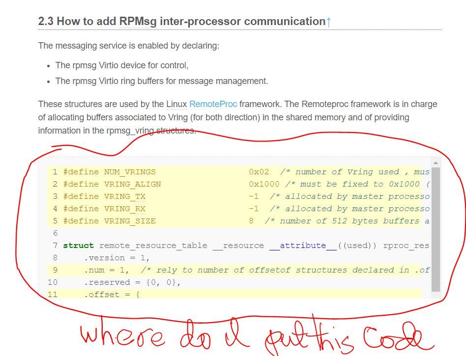

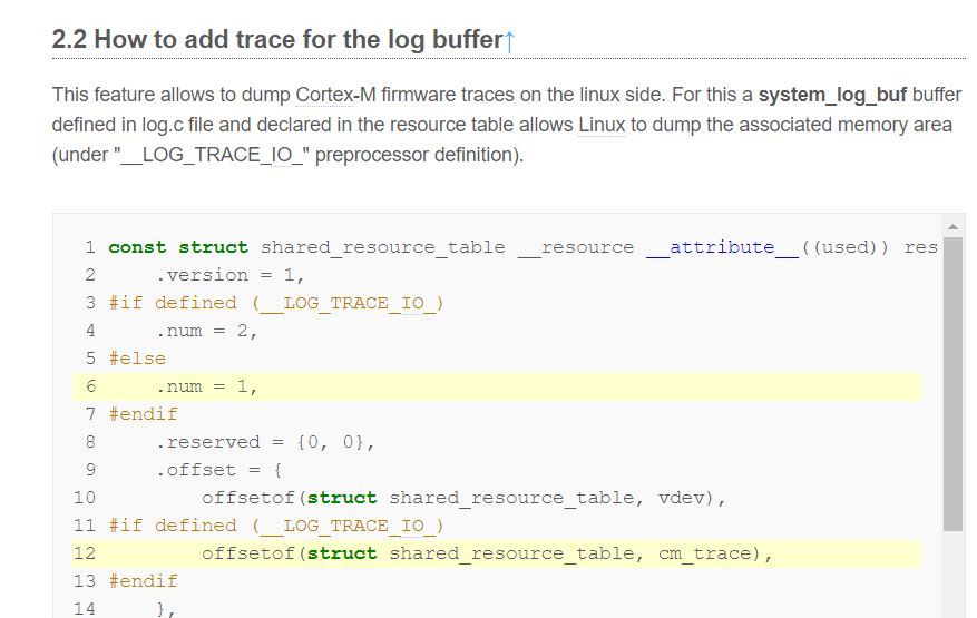

I was reading this post https://wiki.st.com/stm32mpu/wiki/Coprocessor_resource_table and found that I have to have this code somewher in my M4 firware

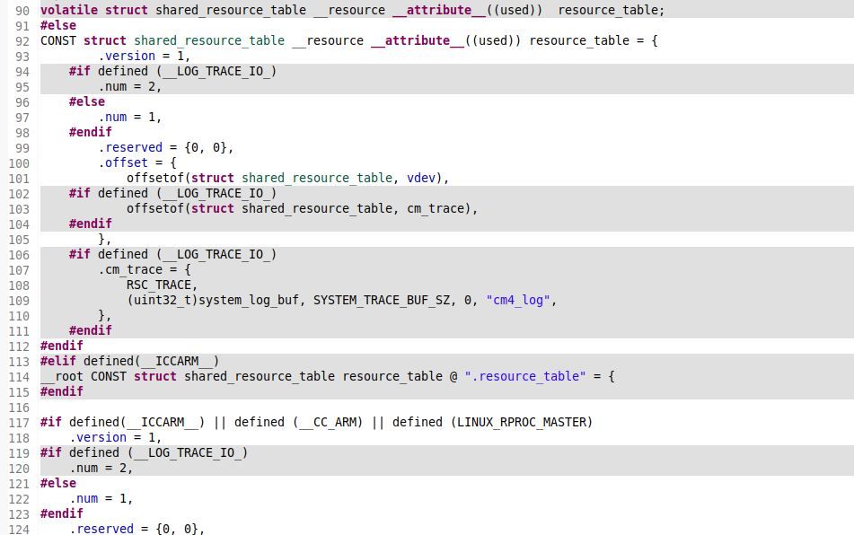

which I managed (by trial and error) to add in my rsc_table.c as (note sure if that was correct)
Then found rhat I also have to add this code somewhere, but not sure where: whether it is in A7 Linux userland or in M4 firware. Played around many times for over 14 hours and got frustrated.

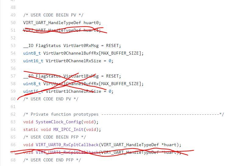

There are some differences between my main.c file and the one used in the example above. In my plan, I assumed that there will be only one virtual UART channel for sending data from A7 to M4, I did not think that I need a wake up channel, so my virtual UART declarations does not include virtual huart 1

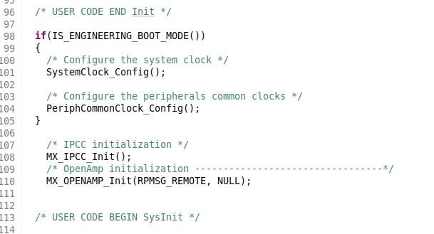

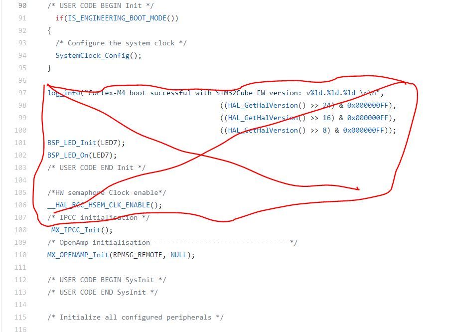

Then in the initialization, my code misses the whole of the following section; I don't know what it means
Instead, my code on that part reads as follows

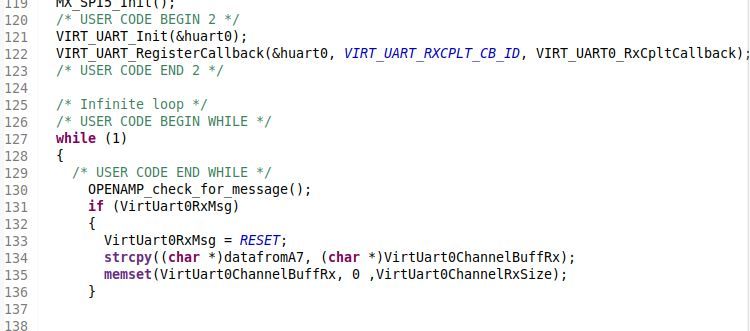

At the end I enable M4 to start receiving data from A7 as follows

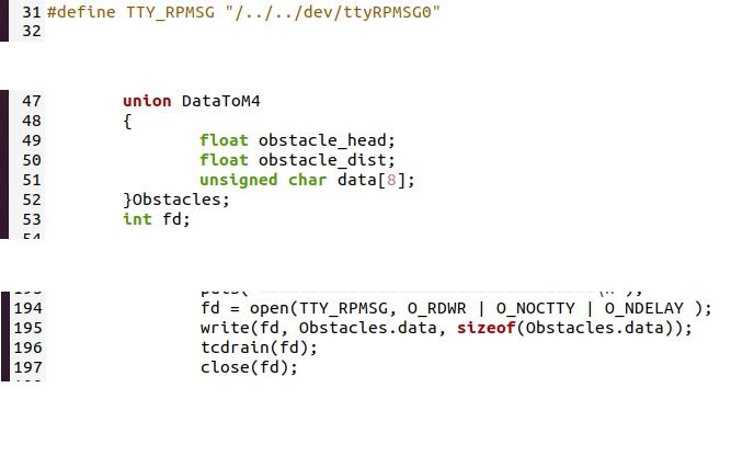

I your view, where do you think I mess up in my code? The A7 Userland application works by just writing the exchange data into dev/ttyRPMSG0 in a continuous loop as follows:

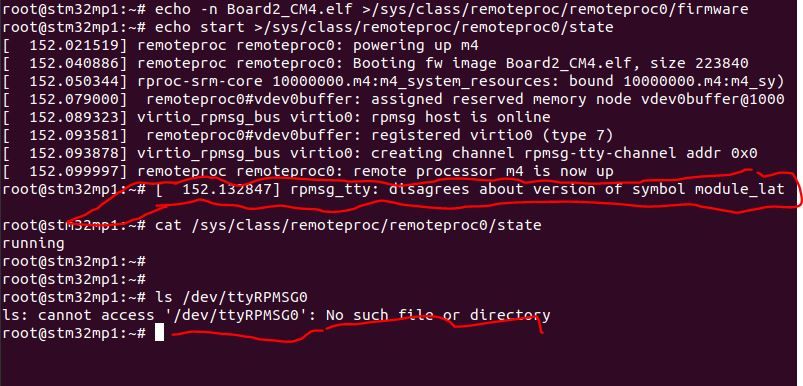

Hello @ArnaudP So far I was able to start the M4 firmware but I get a tty error bas shown below; any idea why? The code is exactly more or less like the tty_echo example
2021-08-25 5:38 AM
Your rpmsg_tty.ko module seems outdated, you probably recompile your kernel with some additional patches without updating the associated kernel modules.
Here is a tips to avoid to update modules each time you recompile the Linux kernel:
In your Linux kernel source directory
echo "" > .scmversionThen recompile your kernel

The fact that you have an error message on the rpmsg_tty module indicates that the RPMsg communication has been well initiated. Indeed the Linux kernel received a first RPMsg from the Cortex-M4 firmware. At least from remoteproc node your Linux DT is correct.
