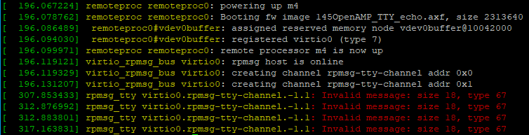

I am trying to establish an interprocessor communication between the cores A7 and M4 with the with the Stm32MP157.
The example from ST "OpenAMP_TTY_echo" works fine, but as soon as I change the received buffer or try to send a costomize buffer from the M4 side, it is not received correctly by the A7 anymore.
This error happens even if I change only one character in the receive buffer.
Does anyone have a clue what is going wrong?

2023-02-08 4:14 AM
Hallo @ Erwan SZYMANSKI,
thank you for the reply. This was also my first thought, but I think that is not the case. As I have tried many variations and all have resulted in a similar error.
The screenshot I posted was made with the sample code from STM32CubeMP1 FW Package v1.4.0 (https://github.com/STMicroelectronics/STM32CubeMP1/releases/tag/1.4.0 ) which I modified according to the description ( 9 Modify the firmware: https://wiki.st.com/stm32mpu/wiki/Getting_started/STM32MP1_boards/STM32MP157x-EV1/Develop_on_Arm®_Cortex®-M4/Modify,_rebuild_and_reload_a_firmware ).
I also tried the example from STM32CubeMP1 FW Package v1.6.0 and STM32CubeMP1 FW Package v1.2.0. With 1.6 no Rx callback was started and with 1.2 the Rx callback was started but no log_info(...) texts were output. With 1.4 both worked, so I continued with this version.
I can imagine that it is a driver problem but I cannot explain what exactly is wrong.
hier der von mir modifizierte Code vom Beispiel (Main loop)

2023-02-12 11:05 PM
Hi @Erwan SZYMANSKI,
Thanks for the quick reply,
I have managed it in the meantime. It was a version problem as you assumed, but I'm not using the OSTL but a vendor YOCTO project . However, with the kernel version 5.10.74 I had the above-mentioned misbehaviour with 5.10.153 it seems to work even with the FW Package 1.6.
