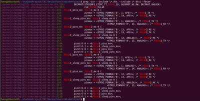

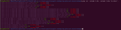

Here is what I'm working with in Yocto:
@Erwan SZYMANSKI mentioned needing to add it to st,clksrc so I grepped this dir for that string and came up with this.
I decided to work with the CubeMX tool to see what it generated. I get a similar directory structure as above with the addition of optee-os. When I grepped the root dir for fdcan, the only instance of CLK_FDCAN (or anything can+clk) is in the optee-os directory.
so I'm still not sure where to put it in order to make dtc happy with the includes and then where to put the resulting dtb, either manually or through the bitbake automation.
