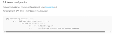

FDCAN:
https://wiki.st.com/stm32mpu/wiki/FDCAN_internal_peripheral
https://wiki.st.com/stm32mpu/wiki/FDCAN_device_tree_configuration
https://wiki.st.com/stm32mpu/wiki/Networking_overview
https://wiki.st.com/stm32mpu/wiki/CAN_overview
Regards.

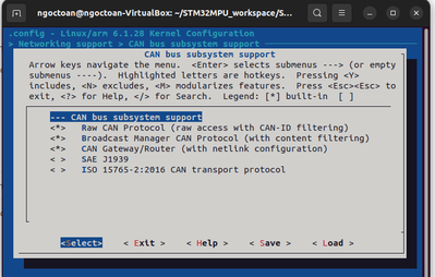

2024-01-04 11:21 PM
hi, I have a problem when controlling FDCAN, there is no option as instructed
